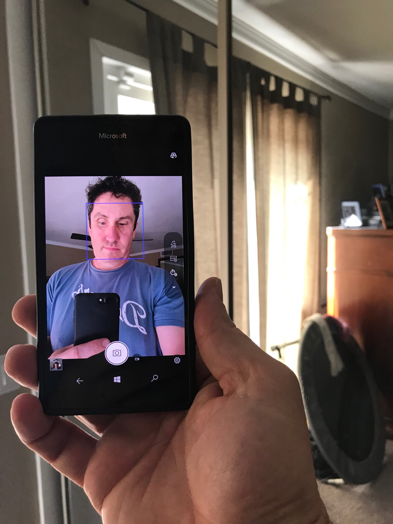

The wife's phone is working fine.
I found an online source (ebay) for the front-facing camera module. I also have the instructions how to tear the phone apart and replace it. I wonder if it's worth the trouble.
