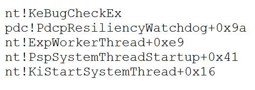

My setup is the Surface Book connected to the Surface Dock, external Surface Keyboard, Logitech MX Master mouse with dongle attached to the dock and a 32" UltraSharp Dell Monitor connected to the Dock via mDP (Dock) to DP (Monitor). All Windows Update up to date and sfc /scannow clean with no errors, below is the outcome from the tool WhoCrashed. Please any help will be appreciated, thanks
* Bugcheck Analysis *
PDC_WATCHDOG_TIMEOUT (14f)
A system component failed to respond within the allocated time period,
preventing the system from exiting connected standby.
Arguments:
Arg1: 0000000000000004, Client ID of the hung component.
Arg2: 0000000000000002, A resiliency client failed to respond.
Arg3: fffff80b27607a38, Pointer to the resiliency client (pdc!_PDC_RESILIENCY_CLIENT).
Arg4: ffffa4006dbacae0, Pointer to a pdc!PDC_14F_TRIAGE structure.
The Stack:
I was resuming from sleep and found out another crash, to be honest I am getting super frustrated with this level of instability, I cannot go more than 48 hours without a crash. 2-3 times a day the crash, at least.

This may sound like a stupid question, but have you installed (successfully) all updates (firmware, drivers, windows)? These errors used to happen frequently on the Surface Book, but that was when the firmware was still very unstable around this time last year.
