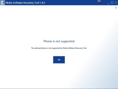

I made the same mistake and installed Developer Program update 14157. Effect - Lumia 1520 is dead. After reboot upon installation it had died. Black screen, unreactive keys. I cannot wake it up in any kind of way. It does not react on any keys push and release. Nokia Software Recovery Tool does not help, phone does not react.

All trials with Nokia Recovery tool ends with information that may phone is not supported ;)

Here are screens of USB devices. You may see info from NSRT.
Any advice how to force hard reset welcome...

Only signal of life is appearance of Quallcom driver in windows upon connection with cable. But no sign of boot. Nokia Software Recovery tool sees that and tells that phone is not supported. And I have no idea how to make it work?

As only chance probably I can see forced external boot and recovery to factory settings. I have no idea how though as Nokia's own software does not recognize Nokia phone...
You can try Nokia Software Updater for Retail instead. I don't think there is an official download link for consumers but you can easily find it by searching the web.

Tested. The same story as with NSRT. Lack of reaction....
