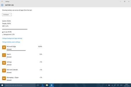

Since I updated my system (via automatic updates) I've seen a dramatic drop in battery life, as before the update I was averaging 8hrs of battery life, after updating my system my battery life went from 90% down to 19% in less than 3hrs!
