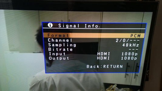

Do you guys get 5.1 audio when you connect your hdmi cable or is it just 2 channel? My receiver shows that the input source is 2 channel pcm whenever I connect my hdmi cable.

Receiver signal input:
Miracast (http://forums.windowscentral.com/nokia-lumia-2520/284372-miracast-netflix-no-sound.html)
I tried Netgear Push2TV (PTV3000) and Actiontec ScreenBeamPro:
I also went to BestBuy and tried it there. Same result...
I also tried a system reset and still no surround.

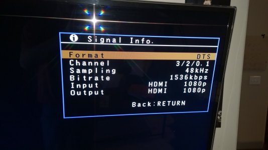

What I want is something like this:
My receiver can do surround. I can do it with my AppleTV, BluRay Player, and Laptop via HDMI. My laptop also shows alot more channels and encoded formats on the sound setup window when connected to the receiver as well.
What am I doing wrong? How do the sound options look like on your devices?

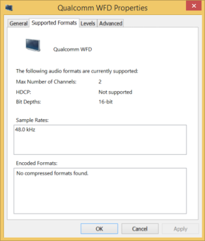

While I'm waiting for Nokia level 3 support to call me back, can someone do me a favor and post a screenshot of their sound properties while connected via HDMI? Open the desktop, click on the sound symbol, click on the TV icon, open the tab "Supported Formats". Can you confirm that you have multi channel audio output from your 2520?
Thanks!
I just got the confirmation from Nokia that the tablet only supports stereo sound via miracast and hdmi.
