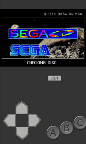

"Nokia 920" Now the sega cd works and everything i put the bios in but, when i try to download a game from the skydrive it logs out of the emulator and then the phone buzzes ?!?! Do you know why this is happening ?! the game is 455MB download "sonic CD" and i cant download it off the skydrive or any other way :P This only happens for sega cd's games :P

Like I said somewhere above, I know m.k. had a lot of problems with his VBA8 emulator reliably downloading "large" ROMs from SkyDrive (and large for a GBA is only 32MB!). So getting a CD image onto a phone through SkyDrive is probably optimistic, especially given this app is still a work in progress. Also it may just be an issue with the SkyDrive API, if you can find some other way of downloading the image through Internet Explorer you may have more luck.

My net at home is not fast enough for test this, I'll check when I get a faster connection. Haven't tested sega cd yet, it is just supported, download large files on wp8 is complicated a lot the OS os too limited to these kind of work( sometimes I feel like using a MP5 - sorry WP fans), at first I thought it would be impossible but now for those who have SD is possible(not on EmiGens yet) . what is the file format? have you tried download from the IE?
Hey, I was able to download the Snatchers iso onto the phone from Skydrive thru IE. The emulator recognizes the iso and tries to load it, but quickly just goes back to the list format.

hi, I've tested segaCD support and it relly is not working :unhappysweat:. Downloading was only possible through IE(skydrive site) but the game didn't started, it loads but get blank screenm the integration on skydrive closes the emulator at random. I'll check and fix on the next update.
