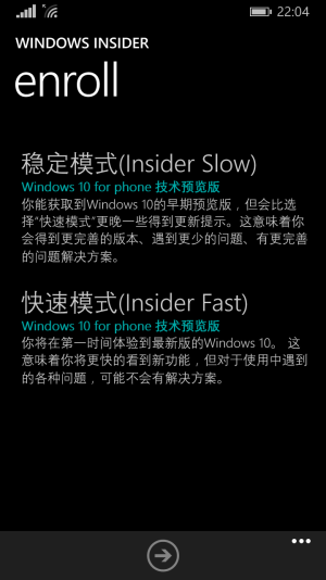

Yes zou can install on any device, but I've read on 2 places so far that W10TP causes boot loop on Ativ S. For now. We'll have to wait more.
I can confirm this. Ran the update on a spare phone using the hack on XDA forums and the phone is now stuck in a boot loop.

I can also confirm that the Chinese hack will result in a boot loop. For both fast and slow update methods.
Just follow the links suggested to revert back to 8-8.1
There is the possibility that these steps could solve this boot loop problem too. It would be interesting to try and install WP10 Technical Build after patching the 4 xml files.
