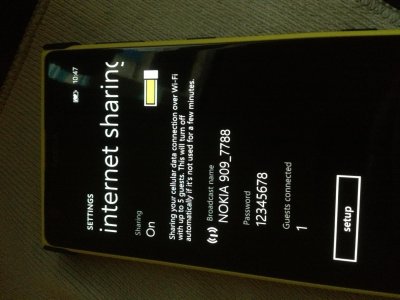

Great to hear everything is working, but nobody has mentioned tethering/wifi hotspot. A few months ago, folks were able to unlock their ATT 920s but unable to tether. Can you tether with your unlocked ATT 1020s (on T-Mobile or an international carrier)?

Sorry for being absent from the thread - yes, tethering works fine once you put in the unlock code. I'm using it on T-mobile now and it works without any issues.

Nope, I'm on TMobile. I try to turn on tethering, and it's telling me to go to att.com/wireless or call 611.

Make sure to use the Access Point app in settings to set the T-Mobile profile, that should override the phone's default settings
Where can I find that Access Point app? I searched in the App store but couldn't find anything. Is it just buried in the settings somewhere?
tethering is working for me. just used internet sharing and connected my mac and old iphone and everything went smooth
So what is the solution? For me it is telling to go to ATT or call 611. It looks like it should work. Because it briefly worked on my 1020! After T-Mobile tech gave me some settings. But does not work since. What is Access Point App? Where can we get it? Any info is appreciated!
ok so apn is listed as
fast.t-mobile.com
and user name as t-mobile lte. what is ur settings? I didn't use the access point app. just input everything myself.
This is exactly what I had today but only once! I have no idea why it worked one time and never since. What could be the problem?!
The question is how did you get those settings in the first place?! Is there any app (txt, or whatever) to set it? I was on the phone with T-Mobile rep, and she gave me 'fast.t-mobile.com', but told me to leave user name blank
no on settings go to cellular. then it says edit internet apn. then for apn put fast.t-mobile.com and for user name put t-mobile lte. then after that click save settings.
