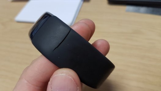

Band 2 band cracked/split
I have a Large Band 2 that I wear every day. After 8 months the cracks have just now appeared. The cracks are due to stress at the point where the rubber connects to the ends of the metal display. My wrist size is in the overlap area between medium and large on Microsoft's sizing chart. I usually have the band clasped tight. No one knew if there was a difference between the sizes other than length of strap so I bought a medium and a large to compare. Besides the medium strap being shorter, the angle of the band display ends is more pronounced than on the large, so that it will fit a medium wrist better.
I was intrigued that some people have had no cracking issues at all, while others have had recurring problems. I have to wonder if the failures are due to a less than ideal fit. For me, the medium band is a little too short - I have it fully extended and it doesn't feel right. But when I wear the medium band, there isn't as much stress at the point where the crack develops. I am returning the medium band and keeping the large one. I will wear it a little more loosely so as not to stress the band at the place where the cracks develop.

Well, only had my replacement of the above Band 2 for 4 months (replacement was lot/date 1620) and here is a picture of it when I woke up today, gutted :unhappy: -
It couldn't be a more identical failure point than my last band 2. Will see if I can replace it, but will have to consider whether to try and sell on the replacement (assuming I'm able to get one) or if I keep it will maybe have to consider not wearing it for sleeping, which is probably where it get most movement I guess.
