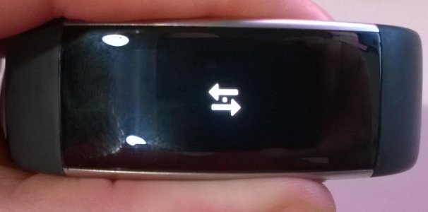

I got my 1st Band 2 a few weeks ago, after a few days of use, I took it off charge and it was dead.
I took it to my local MS store and they swapped it for another one.
When taking my band off charge today, the screen was on, I put it on my wrist and then 5 mins later when I went to look at it, the band was off, wont start up, when I try the 2 button reset, I get the attached icon for a moment.
Anyone else having this issue?
Thought or ideas without needing to go back to the MS store?
