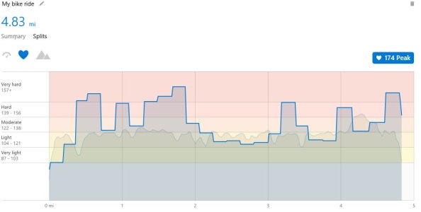

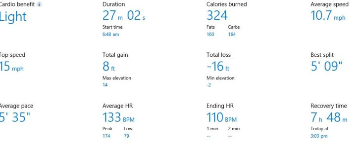

Well... the problem is pervasive now (I I have done at least 5 more bike ride segments (have used the run app and workout app as well with same results) and the spikes and plateaus of HR running up to 175 BPM is happening with every fitness app use. Just like the chart below, it is very consistent; after a short time the band losses lock, spikes up over 40 BPM or so above normal, then locks in and stays in that range. Either on its own or if I stop the app, it drops back down to lock on a normal reading (see chart) and then once again I can see it loose lock, spike up and lock on again. As soon as I shut down the app, it goes back to normal within a minute or two and stays there. I also confirmed on the stationary bike with built in HR reading that while in the bike program it has the problem, but if I shut down the app and watch the HR on an HR monitor app on my phone and compared to the stationary bike built in HR, it is normal. I completed my last segment today (2 miles) with the bike app off and monitored the HR readings from the band and they ran consistently normal. There is no way (I have compared to my timex strap) that my heart rate goes above 125 or anywhere near 175 even for a second. And to show an average BPM of 133, that is of no use for evaluating my fitness.bikeCapture.JPG
I am convinced there is some type of interaction with ME and the apps and the way the HR is locked and calculated. I sure hope someone from Microsoft is reading this as I am not the only one with this problem. I hope there is a software fix before my 30 day return period is up or I am going to have to return it as a fitness band with false HR peak and average readings is worthless as a fitness band. Please Microsoft READ THIS!

Are those dips not corresponding with change in speed/intensity? I don't really know why the HR is charted with many plateaus and drastic jumps rather than a smooth line if it is constantly being measured, but it always seems to correspond with my activity level during any type of workouts. I had one Band with a bad HR monitor that measured anywhere from 20 to 50 bpm too high, but during workouts, the peaks still corresponded with my increased efforts.and the valleys would correspond to between activities or when I would slow to a walk while tracking a running activity.

Not really, Most of my ride is pretty consistent... we are totally flat terrain here. Except for a little head wind, My HR should be around 105-115 and may top out at 120 with a hard sprint for a few minutes. The last 1/2 mile on this chart was a push for shelter due to it starting to rain, but I went back to my other rides and there is really no correlation other than when I first start out the stair-step in the chart is pretty similar to several other rides in the beginning.

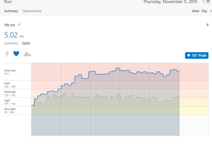

On Saturday I did a 10 mile run with the Band on my left wrist (sync'd with my wife's phone.....that would be Leia), and the Band 2 on my right wrist, to compare HR for the run. The HR for the Band was what I expected (around 165 and constant), while the HR with the Band 2 was higher and climbing. Again, the workout was shown as "Strenuous" on the Band 2 (never had a "Strenuous" until Band 2), while the Band was "Highly Improving".

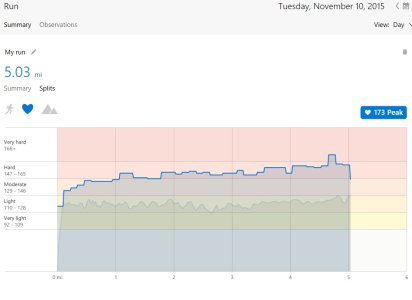

Last night I wore the Band 2 on the outside of my wrist for a 5 mile run. Below you can see the comparison between a run a few days ago with the Band 2 on the inside of my wrist (same distance), and last night's run with regards to HR. Last nights HR with the Band 2 on the outside of my wrist was what I would expect.
Conclusion: Once HR is elevated, the Band 2 worn on the inside wrist does not measure HR correctly. Keep in mind that they moved the HR sensor from behind the clasp, to behind the display. So with the HR sensor on the outside of my wrist rather than the inside with the Band 2, it seems to be measuring correctly. Someone had mentioned that perhaps the pulse through the veins when worn on the inside means that the HR sensor is thrown off. This seems to be the case. I will run with the Band 2 display (and therefore HR sensor) worn on the outside of my wrist from now on.
And the second run was way faster than the first, so if anything, HR would have been even higher, but it's not!
Band 2 worn on inside 5-mile run, followed by Band 2 worn on outside 5-mile run below:

Yep....normal use HR seems fine with it worn "display inside". I ran another 5 mile last night with "display outside", and once more got the figures I was expecting. So I will also be wearing it "display inside" in day-to-day use, then flip it for exercising.

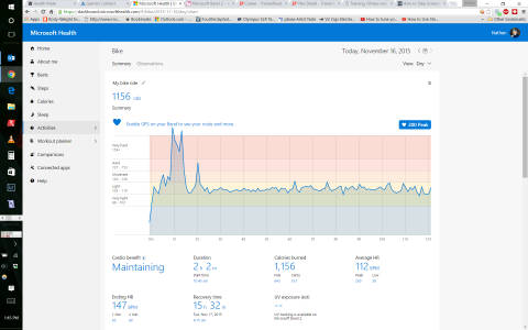

This is typical of what I'm seeing with the hr issue, in this case spikes over 200! My maximum hr is about 165, at least that's the highest I've ever been able to get it. Here, I was spinning very easily and putting out around 103 watts at a cadence of 95 rpm. The Mio Fuse read the hr at this point as 95. As you can see, it usually settles down eventually, and then tracks roughly equivalent to my other hr sensors. It doesn't appear to have as much of an effect on the average hr for the whole activity as you'd think, though (112 for the Band, vs 107 for the Fuse). Its also odd that the ending hr is shown as 147, which is plainly wrong, even when looking at the chart.
