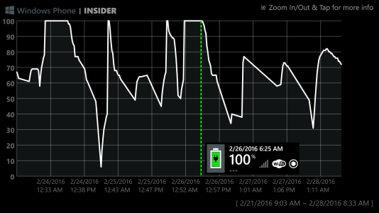

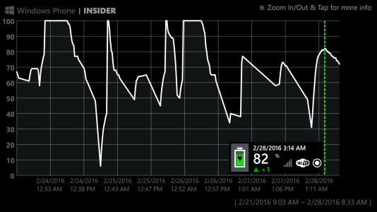

I replaced it in my phone last night and it works well. Like others, I had the issue where the charge status shows as 82% after a full charge. Total install time took about an hour for me. Need to heat the glue on the back of the battery with a heat source to loosen it up (I used a hair dryer) and then wedged the battery out with small screw drivers.
I replaced mine with an aftermarket Nokia BV-4BW (not genuine) and can only charge it to 82%. Which indicates that it is actually a 3000 mAh battery and not 3400. Otherwise it works well, was easy to change out and now my Lumia 1520 is working as new with a full day easily attainable on one charge.
