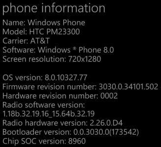

My phone came with the following software right out of the box. Purchased at an AT&T retail store.
