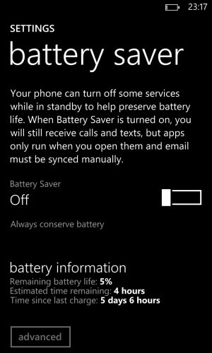

Instead of setting the phone in flight mode, run it on battery save. I have found this is the best way to get the most battery life.
