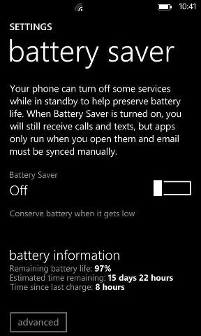

I did not had a chance to test the battery life yet on mine, but there's a ss from todays morning, might not add much but kinda fits the topic :)
I see you dont have the data and voice signal on... that improves the batt lite a Lot ;)
