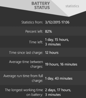

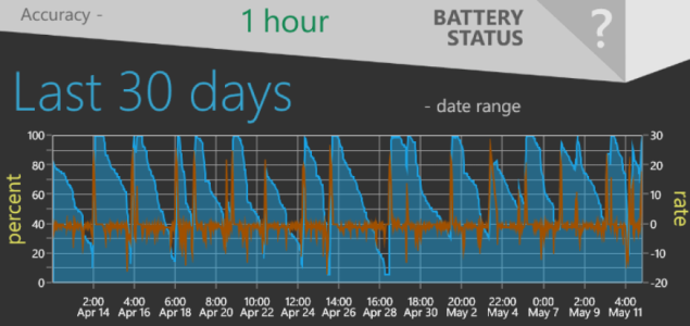

My L535 DS lasts about 2-3 days form full charge to under 5% battery capacity, at normal usage like texting, calls, and some internet. Battery drain when idle (wireless, cellular data and location are active) is abot 1% per hour, and up to10% per hour for calls depending on carrier signal strength. I usually keep my battery charged between 50-85% for best battery life performance.

Thanks for sharing this information.
Based on the charts, the average (total average) battery drain for your phone is ~2%/hr, which should give ~50 hours total battery life - more than two days which isn't bad! :cool:

Keep it up with the 50-85% practice - that is, indeed, beneficial to the longevity of Li-ion batteries.:wink:
Have more than 20 apps that are allowed to run in the background, but during the day only social apps are draining more than 2% of battery, usualy 5-10% depending on usage per app, per day.
About 12 hours the phone is connected to Wi-Fi, the other 12 its on 3G or H+. But most websearching is over the Wi-Fi.
Also i forgot to mention, HERE maps voice navigation and GPS uses about 15-20% of battery per hour.
My longest run was 2 days 17 hours and 3 minutes :smile:
Link to app i used -> Battery status
