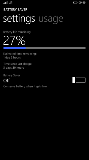

2-3% drain per hour on a 1520 is not good. I get a constant loss of 0.3% per hour over night and that is with
Location on,
WiFi on,
Bluetooth on,
Glance set to peak,
27 apps allowed in background,
10 or more live tiles.
Everything is being backed up
I have turned of WiFi sense and battery sense turned off.
My battery has improved a bit over the last week or so. I was getting between 10 and 13 hours of screen on time over 3-4 days but that seems to have increased by around 15%
I was getting standby battery loss of about 0.2-0.3% per hour on 3g but I'm now getting 0.3% loss per hour on 4g but that could be down to a better signal with EE
