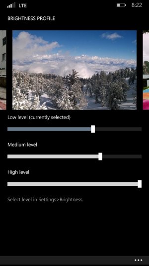

Chance.....can you do me and many others a big favor and show us a screen shot of your "Brightness Profile" so it shows positions of all three sliders. Im not sure where the default positions should be as my sliders seem to be in odd positions relative to each other.
Vivid setting for color really pops out the saturation!
Okay, I've got three screenshots here. I started by resetting the brightness profile, then turning automatic brightness OFF. The first one shows the default brightness profile settings. As you can see, the low slider is well above the halfway point, medium goes up just slightly from there, and high is wide open.

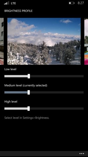

This next screenshot is what I adjusted the sliders to after discovering that--even at the same position horizontally--low, medium and high still represented three different brightness levels. This seems illogical--one might assume that if the slider is the same for all three, the brightness level would be the same. But this is not the case.

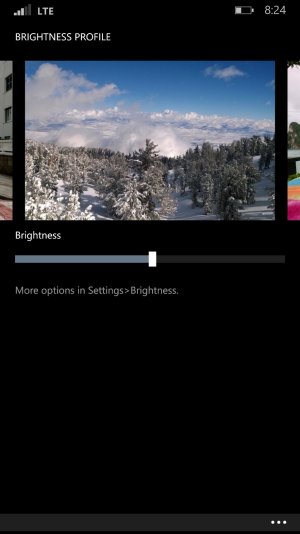

After I got the sliders set as I wanted them, I switched back to automatic brightness. There is a different slider for this (see below). I have not messed with its position. As best as I can tell, automatic uses the L/M/H settings I entered above. These settings, combined with a color profile of vivid, have produced (for me) a very desirable display look--awfully close to that of my old 928, which is brilliant.
