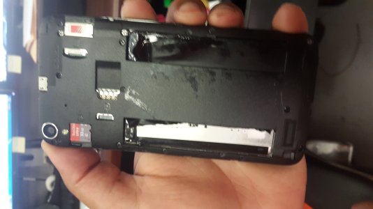

Will try to remove the seal later. Once successful, will order the battery
Re: BLU WIN HD LTE - Weird Charging Issue (charging but percent decreases)
Take pictures and share, please.
Seal removed. That was a ***** to take off. However, there seems to be something else blocking the battery. So it seems that the whole back of the phone will need to be removed.
Not sure what torx those screws are but I'm sure once they are removed, the back pops off and out comes the battery. Need to dig up my torx kit.

Well. I've taken it apart. Screws are regular screws, just need a small screw driver. No torx required.
Getting the screws out was the easy part. Took me a while to actually get the back piece off. That black piece you see down the middle of the battery, that's stuck to the battery.
While removing the back, it felt like it was going to break. it was on pretty tight. Eventually got it off, great right?! '
Wrong.
That battery is glued to the back. It was a ***** to remove. I mean you literally have to pry the battery out. To me it looked like the battery got bent from my prying. (Note. this is not for the faint hearted)
As you can see from the pics, the battery has a jack that jacks into the board. I'm not sure if the replacement battery comes with that. From the pics on amazon, don't see that that clip anywhere.
View attachment 115819View attachment 115820
@rumoredNow, what do you think? I'm also thinking that the clip part is separate to the battery and the battery is connected to that part via another mechanism.
