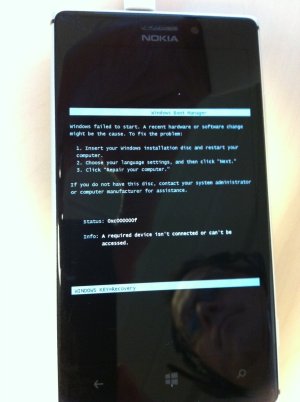

This morning I experienced the exact same thing - only this happens on my Nokia 925.
I tried the mentioned key-combination and the result was as in the picture attached.
Now it constantly reboots only to display the image below.
Yesterday I installed the latest updates for my apps (including Here+ and a couple of others) and I added the Vine app as well as the new Nokia Refocus app.
I guess I'll have to take it back to the shop :devil:

That's the deep, deep, BSOD. Corrupted boot kernel.
Yeah, you'll need to flash a new copy of the OS onto it. Which, unless you're HTC, Samsung, Nokia, or Huawei, you likely don't have. :(

Yup ... the phone is on its way to Nokia as we speak :unhappy:
