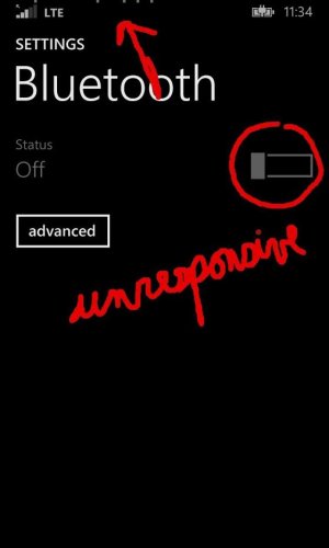

i go to turn BT or WIFI off and the toggle button wont respond
and the "thinking" dots ". . . . " just scroll up top for all eternity.
very frustrating with my new MS Band
i have, as well, done hard, soft resets, recovery tool etc
Same here guys. After getting the MS band it suggested I get full use of it by going to the developer preview and my phone constantly drops Bluetooth and then wifi goes out with the unresponsiveness mentioned by other posters with the moving loading dots
