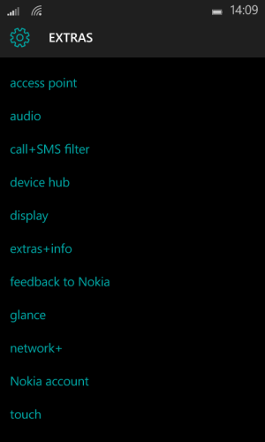

Here, this is how my extra menu looks like right after a hard reset and not updating app via beta store.
Note, it is not a "glance screen", but just "glance."
I even tried installing glance screen from SD card, but no luck.
