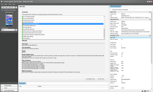

I tried to do some tests with Nokia Product Support Tool and I can agree with swimmer160: it's an hardware defect of OIS.
