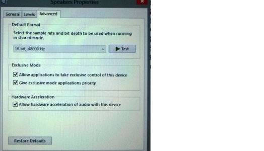

Can you go to the control panel and sound options and see if Windows will allow you to adjust the Default bit rate and resolution?
I have an Acer W4 and this setting is greyed out in windows and was wondering if the Dell Venue Pro 8 had the same issue as they are using the same drivers from what I can tell
Screen shot of what I'm taking about. As you can see it is stuck at 16bit 48K but the actual sound card fully support 24BIT 192KHZ audio. I use my tablet with headphones and high res audio so this setting is important to me.
If you can adjust this setting can you let me know what version of audio driver are on the tablet? I'm not having any luck with Acer getting this resolved and I will resort to making my own driver to fix it if I have to.
Thanks for any help.

Bummer that both the acer and dell have this defect, I've never seen a modern windows pc that had this setting greyed out. Looks like a driver issue with intel then. The hardware can handle it so the drivers should allow it. It probably going to be impossible to get a company to own and fix this problem.

I'm using an acer w4 and the audio sounds really good with headphones the dell seems to use the same sound card which is a realtek sound card with drivers supplied by intel. I got the audio controller specs from acer and the card in here is not bad, it definitely won't drive speakers as it is not designed to but it is more than good enough to drive a decent pair of headphones.
Wish I could just get ahold of a someone either at intel, acer or realtek that would own the issue and either explain why it is greyed out or provide a registry hack of driver tweak. It is literally impossible to speak to a human being at any of these companies about an issue like this.
This is the audio controller the acer uses which I assume is the same as the dell
realtek ALC5642 audio controller
I got an answer from Acer, this will effect the Dell to and any baytrail tablet. Pretty lame they don;t even give us an option to change the setting and it will not be fixed.
This audio problem is a limitation of the LPE (Low Power Engine) utilized with this Intel Bay Trail solution. They say that all systems that use Intel Bay Trail will have this limitation, regardless of who makes the computer. We have formally requested Intel to improve this in the next generation of CPU solutions but there will not be a fix for the current W4-820. It will only be able to a utilize a 16-bit, 48000 Hz sample rate."

Sounds like your only option is an external dac that will take over the sound conversion allowing higher bit rates.
