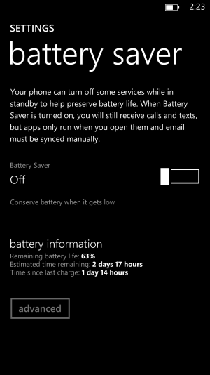

Would you please take a screen shot of both pages of battery saver so we can see where everything is going and what apps are at the top of your page.

I have my brightness on medium and I get around 12 hours screen on time over 4 days between charges. In IE I get between 6-9% per hour battery loss, if I'm on here using the app I lose about 2-3% per hour.
I have 18 apps allowed in the background and Bluetooth always on but not always connected and location always on but only maps and Cortana using it.

If so, can you take a screen shot of background tasks of which programs are allowed. Do you have a Xbox that your phone is connected to? How about Xbox music, also how many email account do you have set up? Do any of the account have a error, and how long are they set to

I don't know how to add a screenshot but I blocked every app except Battery and 6tag. I set my Gmail and Hotmail to sync manually. I don't have my phone connected to an Xbox. None of my accounts have an error.

First up did you do a hard reset and not restore from a backup? If not then do, also what battery app do you use? If its the one with the highest amount of feedback then that is using a lot of battery. I won't go into it now but I did some tests and that one was a real hog on the battery.

WP8.1 - battery drain issue - I too was having a battery drain issue. I turned off the back ground run of Store in battery saver and that solved hre problem.
Battery Saver -> Store -> turn of the Allow app to run in the background.

You shouldn't need to, your right. I have 18 apps running in the background with a load of live tiles and I get 3-4 days from my 1520 with over 10 hours of screen on time.

I uninstalled the battery app. I think I'll just deal with the battery life. I had to reset this phone a million times
