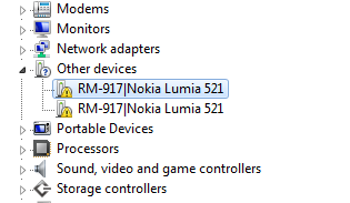

Is it showing in device manager with the phone connected?
Yeah usually it would tell you to unlock it if it was but it didn't and I did unlock it.
Looks like the driver is the problem. Thanks Guytronic. Windows couldn't find it so does anyone know where I can get it?
I'd just reinstall the sync utility from MSFT.
Sometimes just plugging into a different USB port will force Windows to look for the latest driver.
