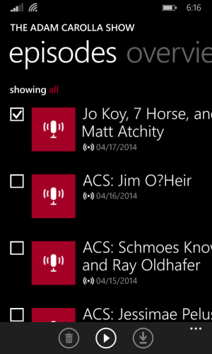

No problem here. Mine is set to download over WiFi though. Also, if you go to the episode list, you can long press an episode and tell it to download.

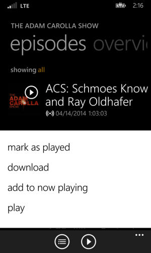

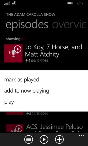

I tried wifi on and off and it made no difference- no option when you select the podcast and it is grayed outwp_ss_20140417_0003.png. I wonder if I have to be logged on somewherewp_ss_20140417_0001.png to download.
It is alo grayed out

I had the same problem, did a ton of research on it, even called nokia/msft support (and was told they don't support 8.1 yet). Finally I ran across a one sentence explanation on some support page that said essentially that one must subscribe to a podcast series to be able to download individual podcasts. Otherwise one can only stream it.
I'm almost certain this I'd different than in 8.0, where you could download a podcast without subscribing to it.
I had this same problem and after much research I ran across a line on a support page that said that you have to subscribe to the podcast series to be able to download individual episodes. Otherwise you can only stream it. This is different than in 8.0, I'm almost certain.
