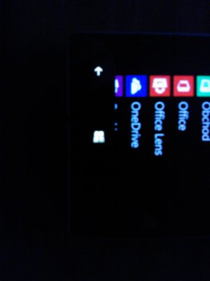

Capacitive light buttons not working after 8.1 Developer Preview install
yes i also got this issue.i updated cyan update after i update developer preview 8.1 dgr1 update after that the capacitive lights not working

I had the same problem but fixed it -> Go to Settings -> Display -> Switch off Battery Saver Brightness - this will turn on the LED lights again.
Hi I was also facing same problem on 1520. However I found solution. Go to setting, goto display, switch off battery saver brightness.... And wolla.. Your capacitive backlight are back again. It worked for me, I hope it also works for other user
Yeah but now on Cyan... i have no option to switch the lights of captive buttons off. Even on battery saver they are still lightened up

Hi guys, this issue is related to Device Hub. Yes, weird but true exactly!
So, -the only one- solution is:
1) Reset your phone (required)
2) When resetting is completed, complete your installation steps
3) When the phone is ready to use, quickly go to Settings > Date+Time
4) Set the year like 2150 or more
5) Go to Settings, tap the Device Hub
6) Uninstall it
7) Set the date as auto again
Problem will be solved.
Never open Device Hub even once! Uninstall it and don't install again.
p.s. If you open Device Hub even once, battery saver crashes and your issue comes over again. Then you must reset your phone to solve it.
If you open Device Hub once, uninstalling it will not solve this issue. You will have to reset your phones...

I have a similar problem but it is very odd. I have my battery saver on and also in display settings allowed battery saver, but my back and home button are still on. just those two..it looks really weird. Sometimes search button glimpse but that's all. I dont know what to do. Im not on developer preview.
