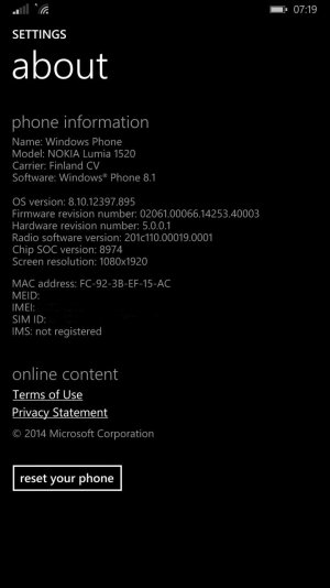

Tomas,
My team would like to help get to the bottom of the issue you are experiencing with your Lumia 1520. If you are willing, could you provide answers to any or all of the questions below to help us figure out what is going on here.
1) Do you have any other live tiles pinned to your start menu? If so, which ones?
If not, pin one and see if you have the same issue.
2) What type of connection do you usually use when you are experiencing this? WiFi, Cellular?
3) How many Cortana interests are you tracking?
4) Have you pinned any individual interest live tile?
5) Can you send a screenshot of Settings-> About (expanded) to help understand more detail of your phone?
Thanks

1) Several. Messaging, Calendar, Linked Inbox, WP Central, Insider (battery meter), Amazing Weather, News, Battery, Photos, 500pix, Health & Fitness, Magnify, Zinio, Skype etc,
2) Both. Although I see that on WiFi it's less frequent.
3) 18 in total
4) No
5)
One more observation; looks like the issue is well connected to location. Often it happens on move, rarely (but not never) at home or work.
Hope it helps.
Thanks,
Mark
