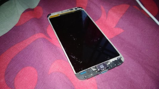

Nothing is impossible. I separated the glass from the AMOLED without breaking it. You need heat to do this.
Those white things are glue still stuck to the screen. Need to clean it up later
jomarr
Sep 12, 2012
585
re:
