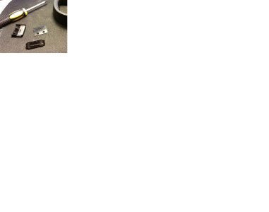

Same lot number. I'm glad mine isn't coming unclasped. I took apart the locking mechanism and found the spring inside was binding and sticking at an opening in the groove where the spring sits. When I put it back together the tabs were sliding perfectly until I closed the band. Now I'm back to the same problem. Hopefully, they'll restock soon.

Do this over a broad surface so that the parts won't fly away on you. I did it over a white flannel bed spred. Unscrew the two screws using a torx wrench. I am not sure what size it is, but I believe it is a T3. I used the smallest one from this kit: http://www.amazon.com/gp/product/B0...ag=hawk-future-20&ascsubtag=UUwpUvbUpU2854580
Once you take the screws out, the clasp will fall away from the band. Inside the clasp is a metal sleeve that holds the two buttons. It can be popped out as unit by pushing one button in and slipping it out of the button slot. The other side will come out easily once you get it out. Flip the sleeve over and you will see the spring that pushes the two buttons apart. In my case, the spring had slipped out of position and was not holding the two buttons apart. I pushed it back in to place with a small screw driver and saw that the two buttons now had good force pushing them apart again. I then reassembled the clasp. It has been working perfectly since then. Be careful not to lose the two screws. They are very small and short.

Here is a picture of the spring loose. Thank you to sdrexler11791 and OwlPower for your posts20150822_150241 (2).jpg
