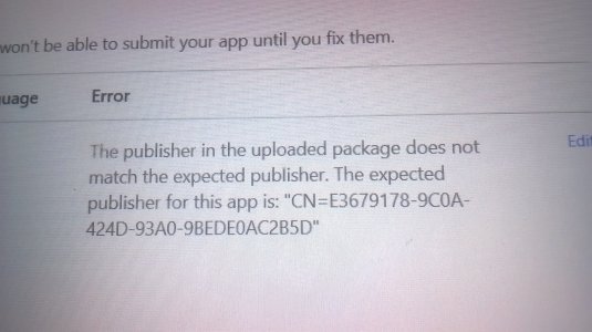

I made an app with AppStudio, Currently I'm trying to submit it, but I get this error. I've added store association to it, put all my information in there, and it still gives me this error. Please someone, help me. I'm literally on the verge of flipping a table. I've spent the last 2 hours trying to get rid of it.
Easy to fix: Open your solution file in Visual Studio then right click on the project from the solution explorer tab and go to "Store" then select "Associate app with the store" you will need to sign in to your developer's account and then select the app then Visual Studio will automatically pull down all the info required for the package. after this create a new package for upload to the store, once done the dev center should accept your app submission and will start the certification process.

I have a 32 Bit system though. Is there a online version of it?

With a 32-bit system you wont be able to run the app in the emulator because hyper-v requires 64 bit processor with a feature called SLAT *Second Level Address Translation). However, you will still be able to debug the app on your lumia after unlocking it for the development. Also, associating app with the store listing should work fine whether on 32 or 64 bit system.

Crap. I only have 1GB of space on my tablet.

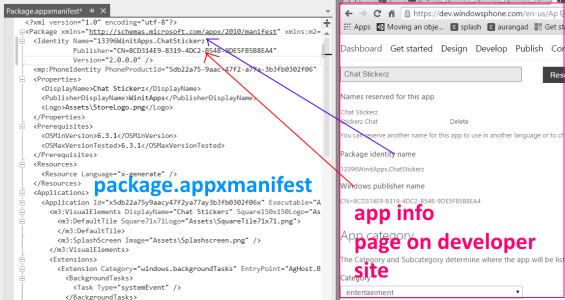

Ok, how about you copy the publisher number that was expected to your package manifest.
Posted from my epic Lumia 925 using taptalk.
Ok I meant copy it and paste it in the package manifest file of your project. Hopefully this will fix it
Do you have your same account on the idle? I think its something about that...
Hello you need to copy info from your "App Info Page" on app dashboard on developer site to your package.appxmanifest file in VS Solution
Thank You, Is there any other way to do this without Visual Studio? I don't have enough space for it.
I dont think that it is possible to do it without visual studio , but you may try to unzip your .xap file find the package.appxmanifest file and edit those values .
