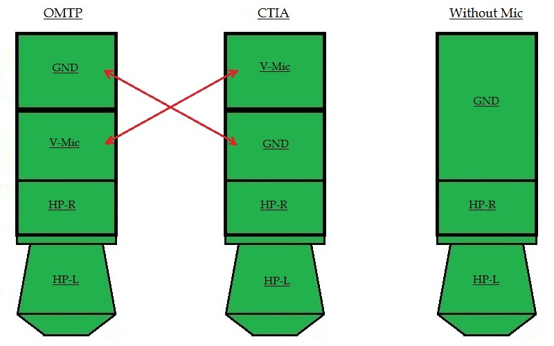

Xbox One Headset Adapter only supports the CTIA headphone jack Standard
So I have found that the Xbox One Headset Adapter only supports the CTIA headphone jack Standard. I have been trying to use my Beats headphones with the adapter. I get great game and chat audio. But my mic doesn't work. I have been doing some researching. There are currently two 3.5 mm headphone jack standards. They both will fit each other because they are shaped exactly the same. The two standards are CTIA and OMTP. The funny thing is the standards are almost identical. If you look at your headphone jack. You will see 3 blacks lines that separate it into four parts. Let's say the tip is the bottom of the headphone jack(there is a graphic below I found from BlogSpot). CTIA from top to bottom is mic, ground, right, left. The OMTP standard from top to bottom is ground, mic, right, left. The only difference between the standards is that the Mic and the Ground have switched places... That is ridiculous. lol. Anyway to find out for sure if my beats were actually the OMTP standard and not broken I had my brother join a party chat with me. So to test I inserted only the first three parts of the head phone jack and let the fourth one visible. So the mic is now lined up as if it was CTIA standard. I did not get any audio because the tip wasn't all the way into the adapter. But I did get the Mic to work. So if you want to know if your headphones are OMTP just put the first three parts of the jack into the adapter and see if your mic works. I couldn't find anything about the Beats online saying they were the OMTP standard. Which is pretty stupid. I know it is super technical but it is nice to know. Anyway. So back to the issue at hand. The adapter only supports CTIA. I have binged OMTP to CTIA and it appears there are some converters available. I'll probably end up getting one. But it seems that they are only available from some websites I have never heard of and ebay has some sellers. I'll be sure to update once I find and actually get a converter to try out. Hope this is beneficial knowledge for others.

The AHJ (American Headphone Jack) is a Standard, and the CTIA is an organization...that is how I read it. But I cannot find out what CTIA means...their website says it stands for "The Wireless Association".........haha
The OMTP (Open Mobile Terminal Platform) is also an organization that created a standard (and that standard was just called OMTP for simplicity)...but is no longer around it appears.
To put it in terms that are more common around here, the WPC (wireless power consortium) uses the Qi standard for wireless charging. WPC => CTIA; Qi => AHJ
​That is where my research is taking me at least.....
