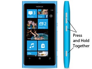

I'm having major issues with my touchscreen with lumia cyan. Is there a difference between the power+volume+camera buttons reset and the settings->about->reset my phone? What state will each option take my phone to?

Power + Volume down = Soft Reset which is the equivalent of removing & reinserting the battery.
Settings > About > Reset your phone = Hard Reset which takes your phone back to factory settings.

There are two types of resets which are known by many different names, which can be confusing:
soft reset, reboot and restart are all the same thing, and equivalent to removing and replacing the battery, or doing ctrl-alt-delete on a PC. The important thing is that this doesn't delete anything on your device. This is achieved in two ways:
- shutting the device off and then restarting
- press and hold power + volume-down buttons.
hard reset and factory reset are also the same thing, although the later is a bit of a misnomer because if your device left the factory with WP8.0, and you have since upgraded to WP8.1, this won't take you back to WP8.0. This just deletes everything on your device, including apps, but excluding the OS. This can also be achieved in two ways:
- settings>about>reset menu
- press and hold power + volume-down buttons + camera buttons
