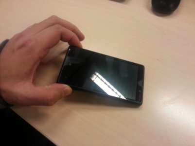

I have a strange problem with my 820.
The glass front does have a stripe (2cm thick and 8 cm long) on the display that has a different surface than the rest of the display.
If the screen is cleaned perfectly you can't notice it. But the stripe attracts fingerprint a lot more.
You cant even feel the difference with your finger. A small piece of toilet paper with a little water is needed to feel a additional resistant when sliding over the surface.
Could not clean it off. It's like micro structure.
Does anyone has the same problem? Not sure if i should return it (bought online with contract)
Worst case with lots of fingerprints and bad light direction to show you the problem.

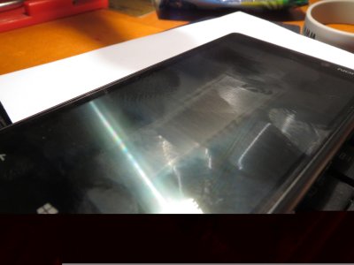

I have exactly the same issue on my Lumia 820, when the screen is clean everything looks fine, but when it has been touched a few times very fine long lines appear, when I bought my phone I also purchased the O2 Large Universal Smartphone Starter Pack and the holster that came with the phone has these pattern of long fine lines on the inside, the width of the damage is the same width as the magnet.

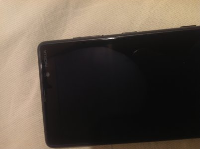

I have exactly the same on my screen. I think it is actually the top laminate has been scraped as mine just suddenly appeared after a drunken night out.
