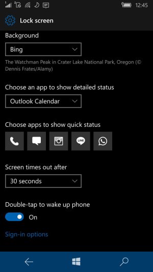

I installed new FW this morning on my L 950 DS Croatia, unlocked via WDRT. Updating 19 apps. Double tap is working, and I will spend some time to download all my favorite apps because I wont to have a clean install.
So fare so good. :excited:

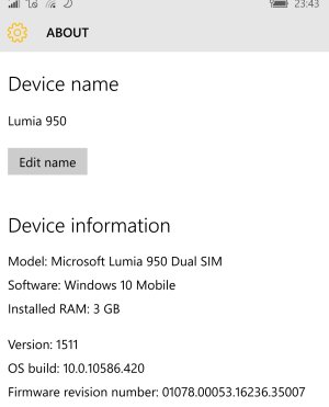

OK I just upgraded OS to 420. Unfortunately, I already upgraded, and installed build in and my apps, so again I don't have a totally clean install but never mind for now. I used mob only to install apps and use it some nav app (maps). With map app I heaved a problem. There was no sound over a Bluetooth, after few min sounds was on but with a big delay. That was before v420. I will delete connection with my hands free, and pair devices again on a new OS build.
Will post my experience tomorrow.

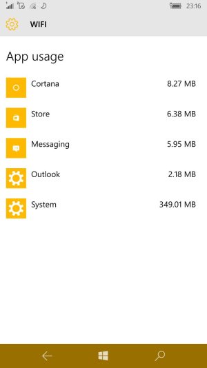

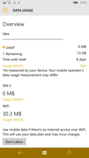

I got this update with the help of Microsoft device care in India as I have Lumia 950 due to some problem in battery backup. all features are working, moreover i have Lumia motion Data is available too. But I have some problem as all apps/games downloading are ok, but its data usage in settings showing in system as compare to store as it shows only 30MB but when I click Wi-Fi usage its system shown 349MB. See more details in images.
Any other user have same bug, what solution will be there?
