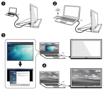

Dears,
as you know we have on the docking station a type-c port where to connect the device. I purchased the ASUS MB169B+ with Type-C input for power and AV signal but when I connect it on the dock station, nothing happen.
Does it is able to stream also a/v that port as fully Type-C 3.1 standard?
Does it work when directly connected to the x3? If not, it may require drivers that the x3 doesn't have (although most displays with USB-C should be able to support any device using standard USB-C, including the x3).
I believe the USB-C port on the dock supports everything the main device's port does (except power, since it uses the HP notebook adapter connected to the dock), though I may be mistaken and don't have a USB-C display cable to test with.
Good afternoon,
no it is not recognized at all...
