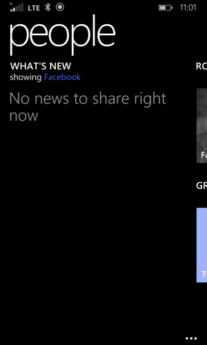

Just wondering if anyone is also finding their Facebook feed in the People hub has gone AWOL. App is installed and connected to phone, also tried a manual sync but the People hub just shows me 'no news to share right now". Anyone else seeing this?

Just verified on my L925 (TMO), that I'm getting feed just fine in the People hub.

Working fine here. I would blame Facebook before Update 1 (Don't know if Update 1 is what you were referring to with beta town).

Thsi can happen sometimes.
Usually to fix this open FB and go to Settings. Toggle the setting to Off for 'Connect My Phone'. Toggle it On again and Press 'Sync'.
Once this is done, you should have yout FB feed back in People
