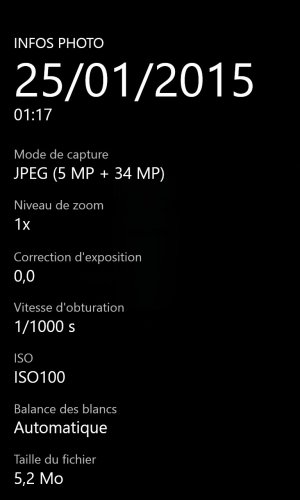

The first one is the resulting photo from the capture; it should be darker if the shutter speed is truly 1/16000 s.

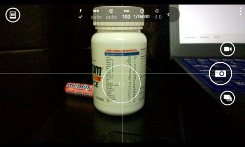

The second one is the screenshot of the viewfinder before taking the photo. Do take note of the settings that I have used: ISO-value is 100, 1/16000 sec shutter speed, flash is on, focus is pre-set...
The third screenshot is the EXIF data; it turns out that the camera used a shutter speed of 1/1000 seconds instead of the desired 1/16000 s.
So, what I would like to know is, what is stopping my phone from using a shutter speed faster than 1/1000 seconds when flash is enabled? Is it because of some automatic algorithm, or simply a hardware limitation whereby the xenon flash has a minimum shutter speed of 1/1000 sec?

I had this exact question to Juha Alakarhu when I got my 1020. His answer was that with an exposure time < 1/1000s, the flash can't sync. So if you want to force the shutter speed, be sure to select a value >=1/1000s, if not, the flash won't fire.
Ah, I see. Then what I have read on other blogs and websites have been incorrect; most (if not, all) stated that the flash can sync with the minimum shutter speed (1/16000 s).
