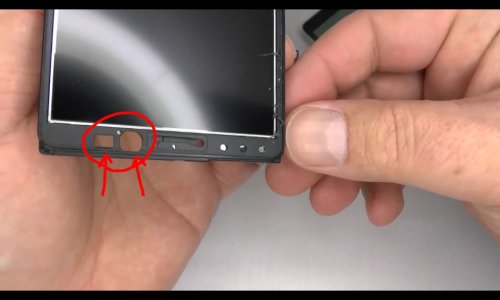

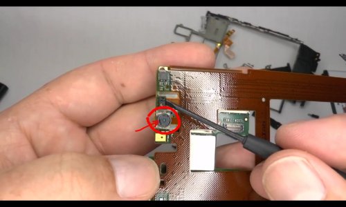

Let get the clue how dust gets in:
(All photo was a screen capture from an youtuber: LE55ONS (http://m.youtube.com/#/user/LE55ONS)
1. This photo shows the size of the front camera unit:
2. This photo shows the frame of the front camera on the plastic bezel for the display unit. It is too close to the edge of the bezel. It remains no room to seal with the glass on top.
3. You can also see on the display glass how close the area for camera and proximity sensor with the display edge.
So, if you have seen all these photo...
You will know, Nokia will need a smaller camera unit, so that they can make the hole on the frame smaller and not to occupy whole space between the display and the edge...
They need to re-engineer on the whole display module to place each components at proper place to provide enough space for sealing it tightly.
