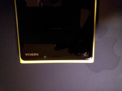

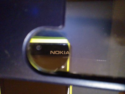

I am attaching a few pictures for your reference. Sorry for the crappy pics from my crappy camera.
Silicone was only applied to the area above the FFC and proximity sensor, where I could visually tell there is a gap under magnifying glass. It was done by a few passes
and each time with very little silicone gel carefully applied to the gap with a needle threader. Even after this is done, there is still a groove in between the black
rubber seal and digitizer, but enough to seal the opening to prevent dust from going in. If you can find silicone seal in black color, that would probably be better.
The clear gel works for me and you won't notice it's there at all. Over the time, mine has collected lots of dust in the groove anyway, but none in the FFC or P-sensor.
I hope this helps.
