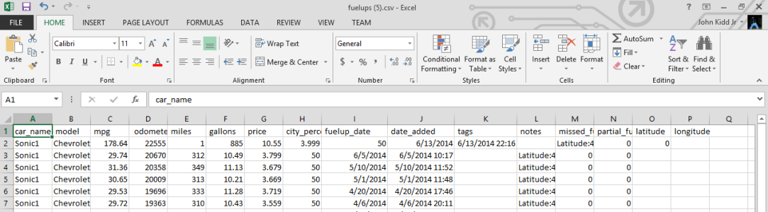

The fuelly.com site is broken as far as what I use to generate all the data. In its current form it will work, but some functions have been disabled for now (new user registration, new vehicle adding).
There is also an issue on their end with how I import the fuelups in. I've put in something to help compensate for it, but it might not work for everyone or every time. Example below.
I've reported this issue to them, and I will release the app with it attempting to correct this on the fly, but I can't guarantee it will work long term if they make more changes to the CSV add.
