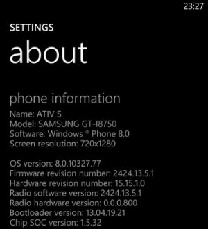

I am curious, I have unlocked ativ still w/o gdr2, I am still on:
bootloader 12.12.20.17
firmware revision number 2424.12.12.3
hardware revision number 15.15.1.0
radio software 2424.12.12.2
radio hardware 0.0.0.800
chip SOC 1.5.32
Since you say it goes according to imei # does anyone who has gdr2 have an imei number beginning w/ 35408405*******

I was wondering if this is the whole problem (firmware version being outdated), is there any way to update firmware to bring it up to date
My is 2424.13.3.1, still nothing... :eck:
