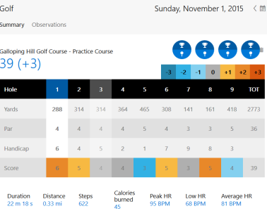

Good afternoon, my wife purchase the band 2 on Friday night for me(early Christmas gift)
I tested the golf aspect yesterday morning at a 9 hole course in union NJ.
The process was very smooth.
I did get an option to chose which hand to put the band on.
I am a left handed player so my right hand is my lead hand.
9 out of 10 in my eyes.
Took 30 seconds to lock in the GPS. tap the action button to get yardage information.
Easy to get in a pattern. Walk to your shot, hit the action put, grab your club and go.
For some reason it had a little difficultly with small chip shots and tap in putts.
My only gripe was the scorecard had incorrect data for holes 4-9.
Example #9 hole is a par 3 scorecard app said par 5.
My score was a 39 +6 over not +3.
Email was send to my round pro to resolve this issue.
The GPS yardage was maybe 4 to 6 yards off my playing partner GPS device.
I hope to have a better review on Thursday night.

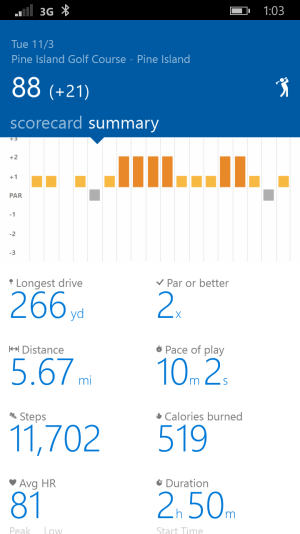

I went golfing on Tuesday afternoon in Minnesota (beautiful weather!).
The first couple holes went without a hitch. But as I was walking to the 3rd tee box, the path sort of goes by the 9th tee box and the band thought I was going to play the 9th hole. I didn't understand what to do at that point because I was teeing off from #3 but the score went in as the 9th hole. (I think that was overwritten when I actually played the 9th hole).
This happened again later in the round too, but by this point I was getting the idea of clicking on the button to set the hole if it was incorrect and swiping left/right to add/remove strokes so I made sure I was on the correct hole before teeing off.
After the round was complete, my score was a bit off since I didn't have a score for hole number 3.
The summary of the round from the health app contains some excellent information and now that I've used it once and also getting a few tips from posters above, I'm looking forward to using it again (hopefully before the snow starts flying).

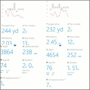

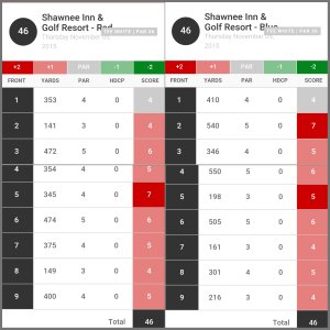

I was able to play 18 holes at Shawnee golf course in the Poconos.
27 holes course Red White & Blue.
So this was going to be a great test.
The front nine was the Red course. Easy process to sync the course.
My GPS yardage was close to my buddy Garmin GPS watch(off by 3 yards)
Maybe one or two shots around 100 yards the band did not recognize.
Now playing the back 9 the Blue course.
It took about 2 minutes to get my phone go on the health app and sync the blue course.
Now i alter my swing to create a more steeper swing this caused the band to record my practice swing.
No biggie just remove shot and hit.
Tip : if the band does not move to the next hole(occur maybe 4 times)
Hit the action button to pause then swipe to the left and touch next hole.
Overall a very good experience.
I wish there was a social media share button in the MS health app/Myroundpro
I have to save a screenshot crop then post on FB twitter etc.
Stats from myround pro and Ms health app.
Enjoy
