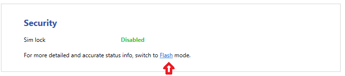

After opening the tool, Go to "info" and click "Flash mode" under the security tab. Your device will be rebooted in flash mode.​
Important : Leave the Windows Phone Internals tool open during the entire process (or at least during the flashing).

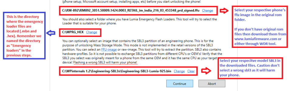

3) Now, go to "Unlock boot loader" and select the required files for unlocking as shown in the below image. This is where the above downloaded files will come into play.
4) Now click continue and wait for the tool to finish the unlocking process. After it is done, your phone will boot normally to your lockscreen.

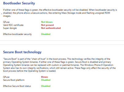

To ensure whether the boot loader is successfully unlocked or not, check whether the status of Qfuse, Effective bootloader security, Secure boot platform, Effective boot status turned to green like as shown in the below image. Only after ensuring, go for next step.​
Note : You will get the info only during the Flash Mode, so before checking the status put your phone to "Flash Mode"

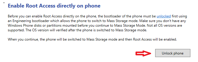

5) Now you need to enable root access in your phone, which is essential for changing the registry keys.
Now click "Enable Root Access" in the WPI tool and click "unlock phone".​
After it is done, a window will be opened in the PC as soon as the rooting process is finished, showing the internal files of your phone, just leave them as it is and don't try to modify them. Your phone will stay blank as it is in the Mass Storage mode, which is perfectly normal, don't panic. We just need to exit this mode.​
Just press Power button and Volume down for 10 sec and your phone will exit Mass Storage mode. And it will boot normally to your lockscreen.​

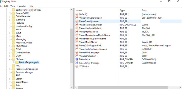

First way
1) Open "CustomPFD Registry Editor" >> REGISTRY TREE >> HKLM >> SYSTEM >> Platform >> DeviceTargetingInfo
2) Edit Registry:
PhoneManufacturerModelName >> RM-984_1006 >> Write​
PhoneModelName >> Lumia 830 >> Write​
PhoneHardwareVariant. >> RM-984 >> Write​
PhoneManufacturer >> NOKIA >> Write​

1) Connect your device and open Windows Phone Internals and boot into Mass Storage Mode.
2) Once you'r in mass storage mode, open regedit in your pc. Select HKEY_LOCAL_MACHINE and goto File >> load hive
a) In the dialog box navigate to MainOS >> Windows/system32/config and select SYSTEM. It will ask you for a name, enter any name (ex: My phone) and save it.​
b) Now Navigate to Platform >> DeviceTargetingInfo and then change the keys as shown in the next step.​
3) Edit Registry:
4) After editing, click unload hive. And then, Exit Mass Storage mode by pressing Power button and Volume down for 10 sec and your phone will boot to lockscreen.​

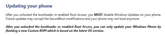

Reason is if you update the phone without disabling the root access and boot loader, the newly downloaded update (especially firmware) might corrupt your phone, leading to its death. You wouldn't want that right?
That is why you see this message in the Windows Phone Internal Tool "Getting Started" Page.​
A warning : First "Disable root access" and then "Restore boot loader", and don't ever never do the other way (i.e., restoring boot loader without disabling root access, doing so will brick your phone.)
4) Head's up - Don't check for updates without doing the 3rd step as it is the crucial step in the whole process.

I would like to upgrade to 10.0.14915
Is the "Process: Part 2 - Registry Edits" enough to do this?
Thanks
Yes. But your device has to be Interop unlocked.
Calendar works fine at-least on Release Preview. Did you check for updates in Store? Cannot confirm on 10.0.14393.67 as I moved to RP ring as this build (14393.67) has some minor bugs which couldn't be solved with a hard reset.
If you want to jump builds, I recommend you to choose Release Preview instead of Fast Ring as you know those builds (Redstone 2) tend to be less stable. I'm on RP ring and the build 10.0.14393.103 works great :)
Hello.
I choose Release Preview and i'm again on 14393.67
Strange
After the update i will try again Windows Insider.
PS : i'm in France. Maybe i must put another RM on registry
PS2 : Yes !!! after 14393.67 i choosed again Release Preview in Windows Insider and now i have 14393.103 on update
PS3 : One question. What's happen if we don't leave Windows Insider at the end before reseting ?
Nothing, whatever be the ring you chose in Windows insider programme, your device registry details will get restored after a hard reset. I mentioned in the step 6 of this guide to leave the programme so as to move the phone from Insider to Production build (14393.67). You can do this manually too instead of a hard reset. Use the custompfd or Interoptools.
So for further updates, you can just spoof the device again and check for updates.
