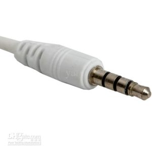

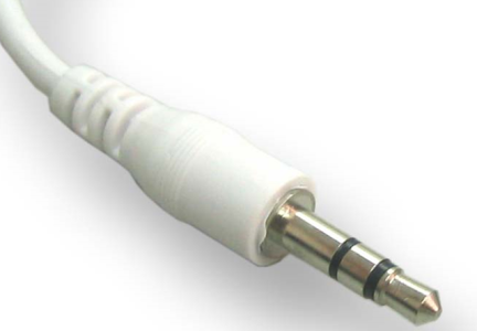

Your English is alright, and I understood you. The jack for your headset and for the stereo aux cable are the same, that is they are both 3.5mm male audio jacks. Here are two images for comparison*:
The first is a regular stereo aux jack. Notice it only has three metal bands, separated by two plastic rings. These are for the base signal, the left signal and the right signal.
Compare that with the second one which is what most headsets with both L&R and a microphone have. It has four metal bands separated by three plastic rings. These are for the base signal, the microphone signal, the left signal and the right signal.
What I'm saying is that this difference might have created a difference in alignment in these metal bands in the audio port of your L1020, e.g. the contacts in your port could be touching the plastic rings instead of the metal bands when you use the stereo jack, so now even the regular headphones don't work.
