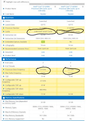

The SP4 situation isn't the same as the SP3 situation. The cooling design is different and the CPU/GPU are different. When the SP3 was being designed, it was anticipated that Broadwell would be on time. It was extremely late and in fact was passed over by many vendors. Some Broadwell CPUs were abandoned entirely when Skylake was on the horizon. Broadwell basically ran into the timeframe of Skylake. Because Broadwell was so late, Microsoft had to keep using Haswell for SP3. But the cooling design of SP3 was not designed to handle Haswell. That's one of the reasons why SP2 was so much thicker with a beefier cooling system because SP2 was designed for Haswell to handle Haswell-level heat (the main reason being that SP3 had a bigger footprint so components could be spread out thinly whereas the SP2 only had a 10.6" screen making the footprint smaller so components had to be stacked which made it thick). This is why i7 with SP3 was kind of a mistake. Under sustained load, the i5 was a far better value as the i7 would throttle.
In terms of i5 and i7 for Skylake and the SP4, the only real differences for the CPU part are the i7 has a 4MB cache whereas the i5 has a 3MB cache. The i7 can scale to higher frequencies for more speed. Once the i5 hits its top frequency, it's done. The i7 has the same frequencies as the i5. But if you need to go above i5 frequencies, the i7 can keep going up to 3.4 GHz whereas the i5 stops at 3 GHz. So the i7 only uses more battery and generates more heat than i5 if it climbs above 3 GHz.
The big difference between i5 and i7 is the graphics. The Surface Pro 4 i5 comes with Intel HD Graphics 520 (GT2) and has 24 Execution Units (EUs) clocked at up to 1050 MHz (depending on the CPU model). Due to its lack of dedicated graphics memory or eDRAM cache, the HD 520 has to access the main memory (2x 64bit DDR3L-1600 / DDR4-2133).
The Surface Pro 4 i7 comes with Intel Iris Graphics 540 (GT3e) which has 64 MB of dedicated eDRAM memory which is far far far faster than system RAM. Furthermore, the so-called GT3e-version features 48 Execution Units (EUs) clocked at up to 1050 MHz (depending on the CPU model). Besides the eDRAM cache, the Iris 540 is able to access the main memory (2x 64bit DDR3L-1600 / DDR4-2133).
So theoretically, the Iris graphics is twice as fast as the graphics in the i5 because it has twice the number of execution units. You don't get true 100% difference between 540 and 520 because the 520 actually has faster texture fill rate (Intel did this to shore up the difference). But shader performance is more important and the 540 has over 2X the shader performance.
