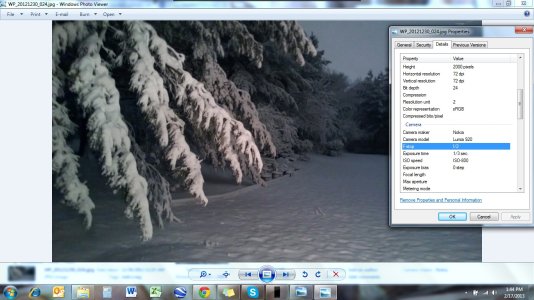

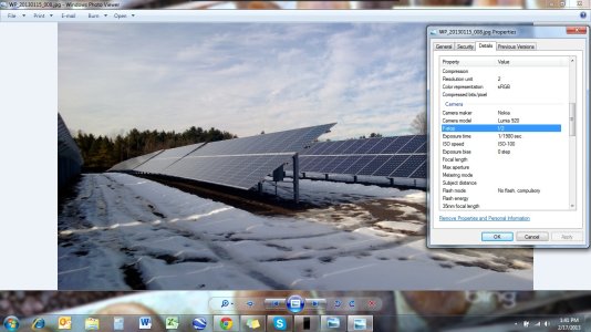

This is where the 920 camera fails. There is no way to manually adjust aperture, and the "auto" setting is absolutely dismal, dismal at adjusting it. In fact, I'm curious to know if the "auto" setting adjusts aperture at all under different lighting conditions. Or if this lens is even capable of an aperture adjustment? So I conducted a simple test to figure it out.
I've taken two photos, one in the dark of night and the other a landscape during a bright, sunny beautiful day (all settings on auto - not that it matters with this locked down software). So how did the 920's camera perform in terms of aperture adjustment?
F/2 corresponds to a completely wide open shutter, and as you can see, it doesn't matter if it's at night or during the day. You're taking a picture with a completely wide open shutter. This is exactly why daylight/landscape shots are blurred out.
