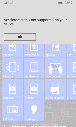

If you can download the hardware test app and chk what that says. It might be able to give you an insight with the issues.
BladerXrz
Mar 8, 2015
9
Re: Nokia Lumia 920 - Accelerometer, Compass and Proximity sensors are not working.

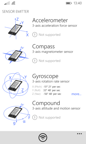

The Gyrometer is the only sensor that is detected..and Accelerometer,inclinometer,orientation and compass..shows not supported on device after running the hardware test app....can this be due to faulty software update or hardware problem?

OK, so I flashed with pre-Amber and Black, and it's a hardware issue, it still doesn't work.
