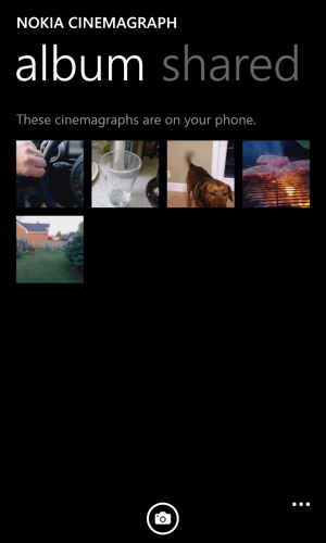

here are the screens I see when you open the cinemagraph app up.
You can see two screens "ALBUM" & "SHARED"

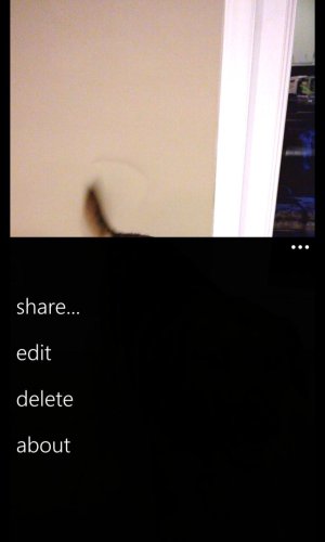

then if you click a picture and hit the menu key you get these options

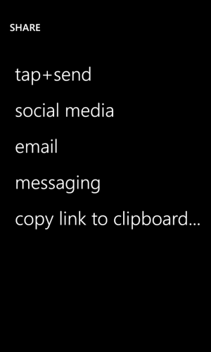

when you click share you get this
OR

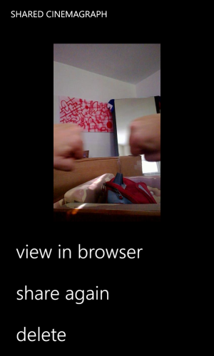

if you swipe over to the "SHARED" page and click on a file you get this for the options, i "share again" alot from here, copying the link to the clipboard then sending as texts or in emails.
